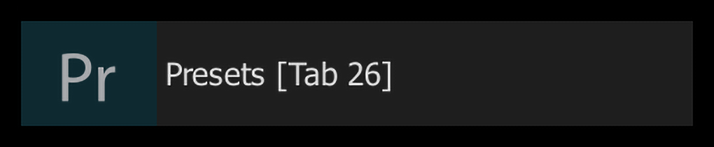

Presets [Tab 26]
Note: [Preset] is used below. Consoles without this hardkey use the following syntax:
Preset can also be accessed via a connected keyboard with CONTROL+ALT+F, or the {Preset} button in ML Controls.
This display shows all recorded presets.
Presets can be opened in a standalone tab from the Workspace Layout Menu or by using [Tab] & [2][6].
This display can also be accessed:
  • Using [Preset] [Preset].
  • Via a connected keyboard with ALT+PP.
  • From the Central Information Area (CIA) under Browser > Record Target Lists > Preset List.
